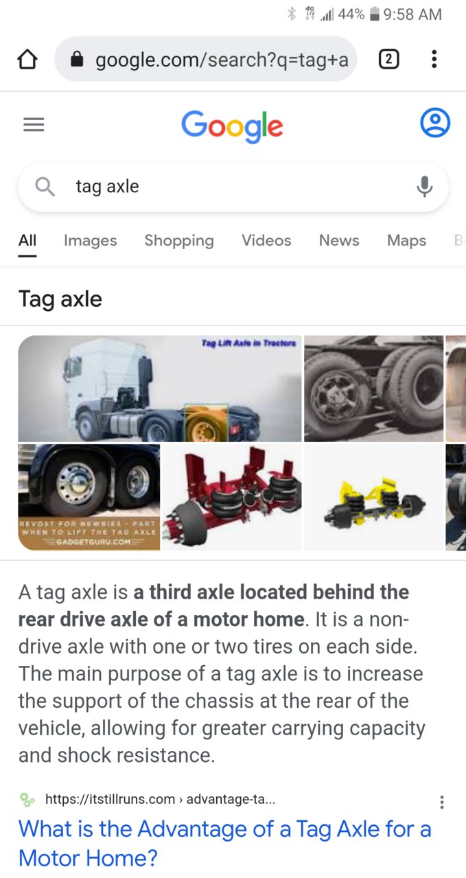

    A tag axle for a half ton?
    Cuz thats what im seeing here

    2012 DCLB
    Tags are different in that they're fixed and will just share the suspension bag pressure line. Spreaders have a pivot (easier to turn) and are adjustable on the amount of load for lift. The OP's is kind of a mix since it doesn't pivot but has an air bag at the tongue. End goal is the same. Does it make sense for a 1/2 ton market? Dunno. You'd assume the OP did a proper market study since he's already invested in IP and press... I would rather unload an oversized pallet from a trailer than have to unhook a spreader from the hitch to get a fork truck in.
    I missed Pro Blanco's post - he has a picture of a spreader. Jeeps are actually placed at the front of the trailer and act as a load divider for the king pin.
