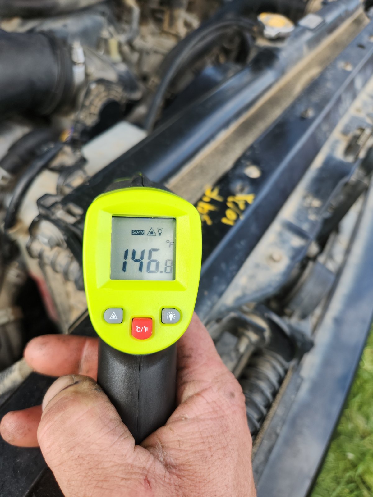

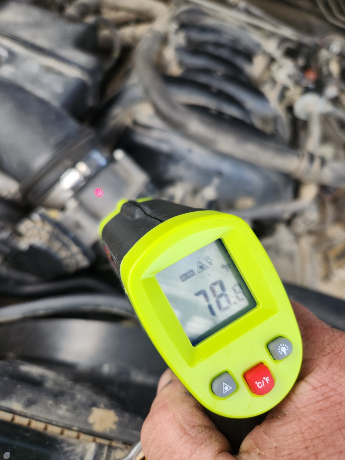

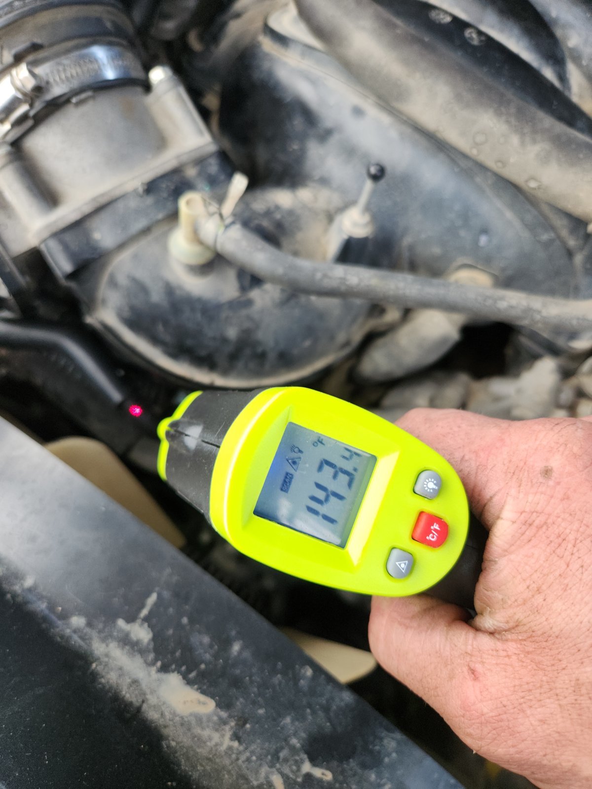

    I figured this mod would be dumb and not have any effect for the reasons mentioned above, but I did it and actually have some basic data from before and after to say it does in fact lower IATs a measurable amount (8-12 degrees). My Harrop blower has an IAT sensor located post TB, SC rotors, and SC intercooler right before the air goes into the intake valves. See this post for my findings. I monitor IATs vs ambient pretty regularly as I drive. I was shocked to find it made any difference let alone that much of a difference.
    https://www.tundras.com/threads/general-supercharger-thread.85513/page-289#post-3209054
