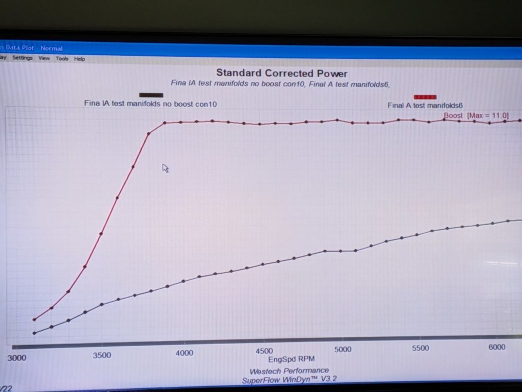

    This is the email I just received.
    The stage 1 kit bring about 400WHP and 430WTQ at only 4.5 PSI and the Stage II we are targeting 500WHP and about 550WTQ at 8-9 PSI Keep in mind, this would be at the wheels on a Mustang DYNO, which these truck pull 280ish in stock form, give or take,, so it's a solid 30HP per PSI!
    I put the give or take in there because there were a couple misspelled words, so I stuck that in there.

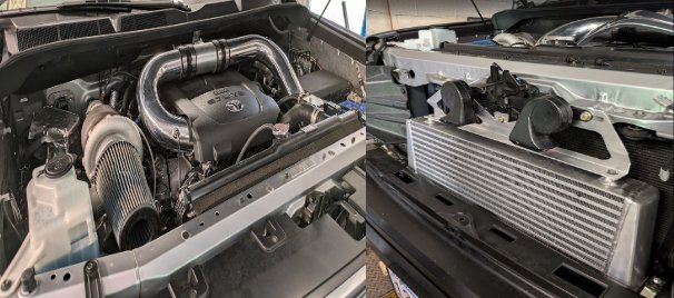

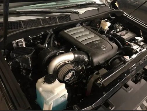

    There's a few now I think, one guy in Dubai is running one for a while and I think you can buy it, the shop is called Race X
    https://youtu.be/OmxaMmNCObc
    Hey OP, I assume this is a single turbo right? so I assume it has a cross over pipe from driver's side to bring it up to passenger side, will there be a support bracket or are they going to run new manifolds? since you are going to have almost 60lbs of weight hanging from passenger manifold.
    I assume intake manifold is left stock?

    Some of this I am not sure of. My main concern was my truck I am not concerned about the where tooos??
    I did get this though it is going to be on the passenger side and they will do away with my CAI . Yes I think they will replace the manifold on that side as they will have to take that off. The stage one will face the intake and the stage two will have to be rotated facing the front as there will be a nice big hole in the front of the truck!!! Ouch!!!!! I have seen a Camaro or two with the stage two and it doesn’t look that awful, I will be able to live with it for the HP!:) my CAT protection plate will have to come off to add a high flow cat and they will see about putting the plate back on.
