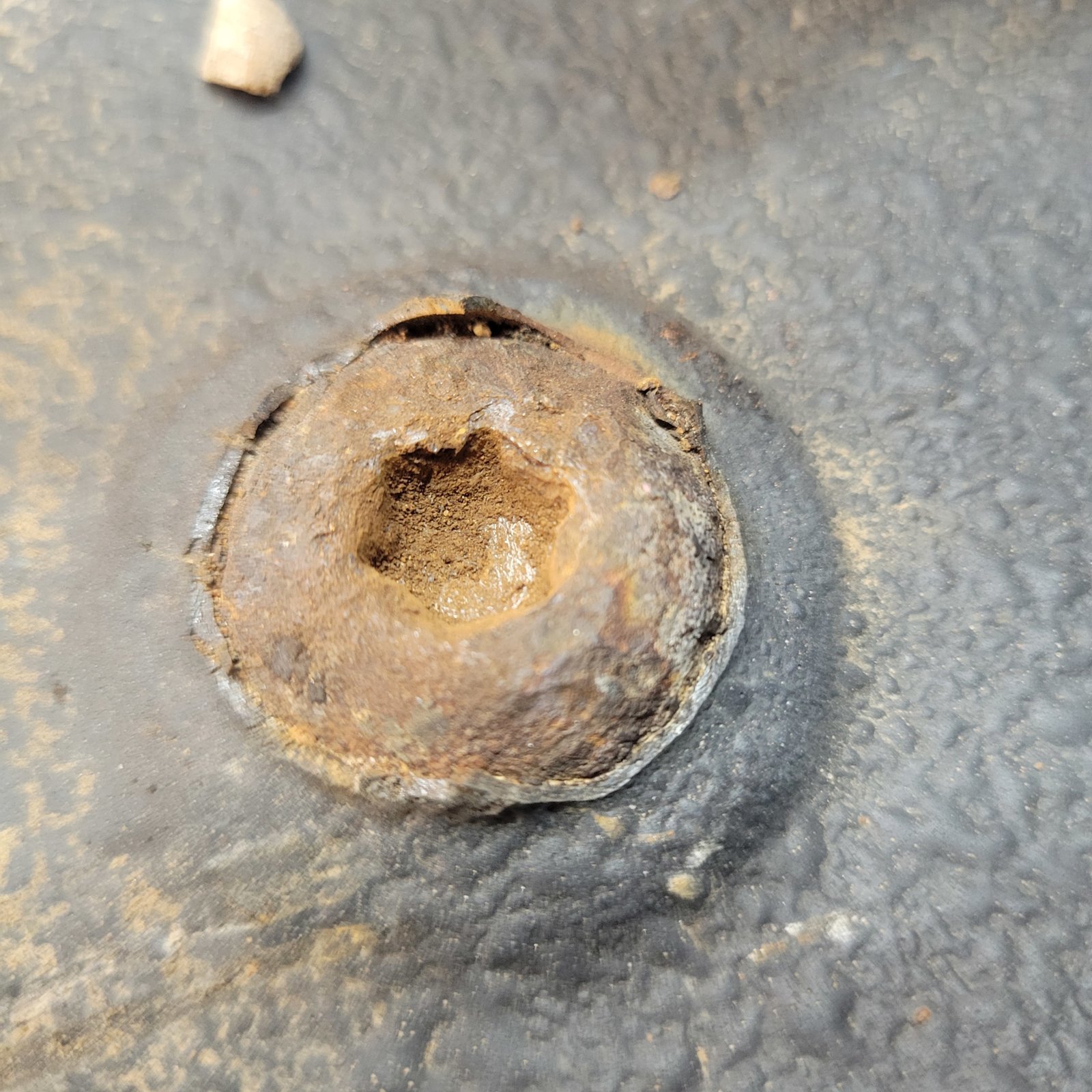

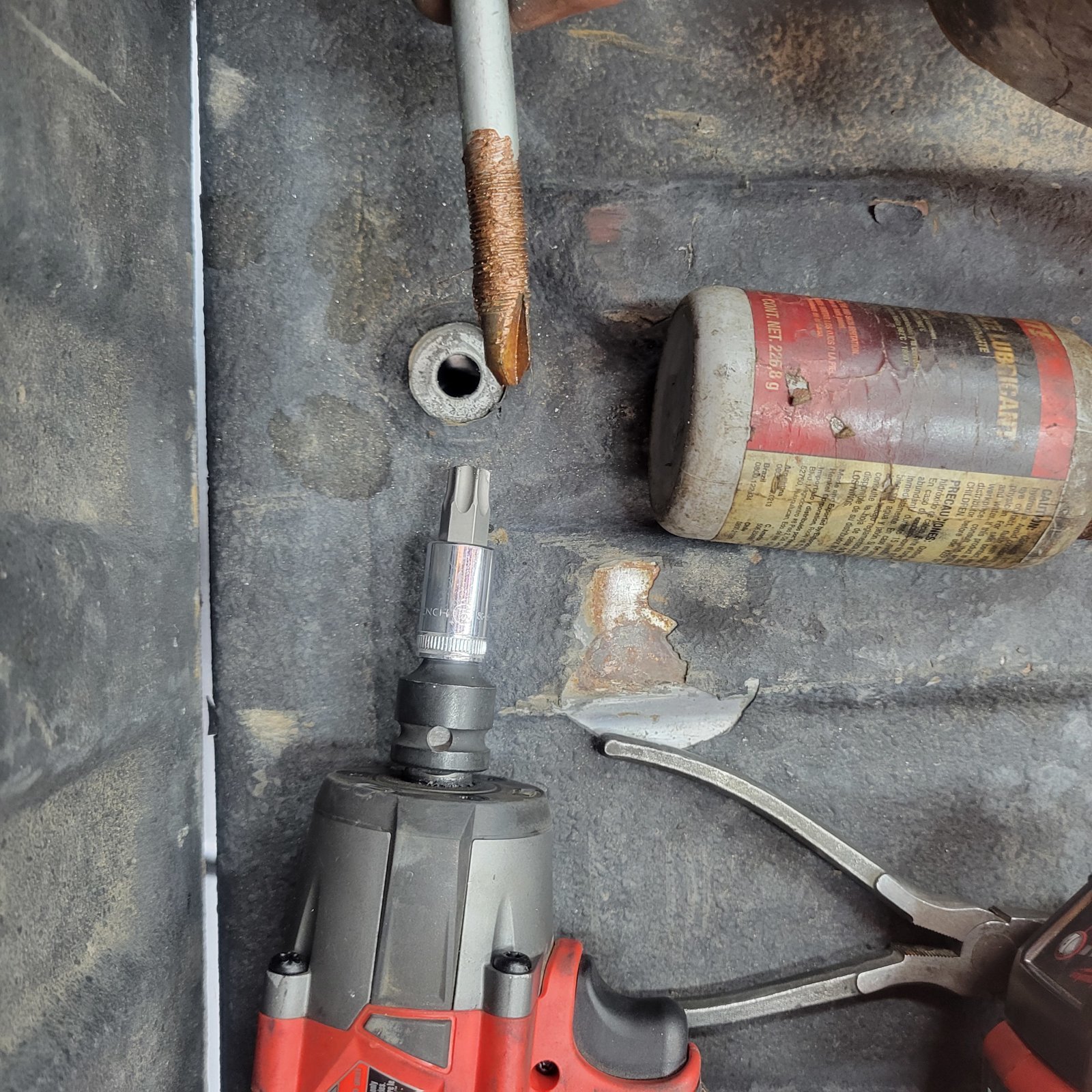

    I pulled the bed bolts so I wouldn't be in for any surprises when I went to remove it for the rear suspension work.
    This was the worst of the bunch, and the one I figured I would have to weld a nut to.
    They all got a liberal coat of antisneeze and lightly reinstalled

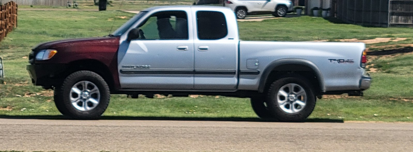

    T-a day or two for rear suspension. As it sits the rear is 1-1 1/4" low.
    Terrible photo, but you get the idea.

    Weight reduction, mostly rust.

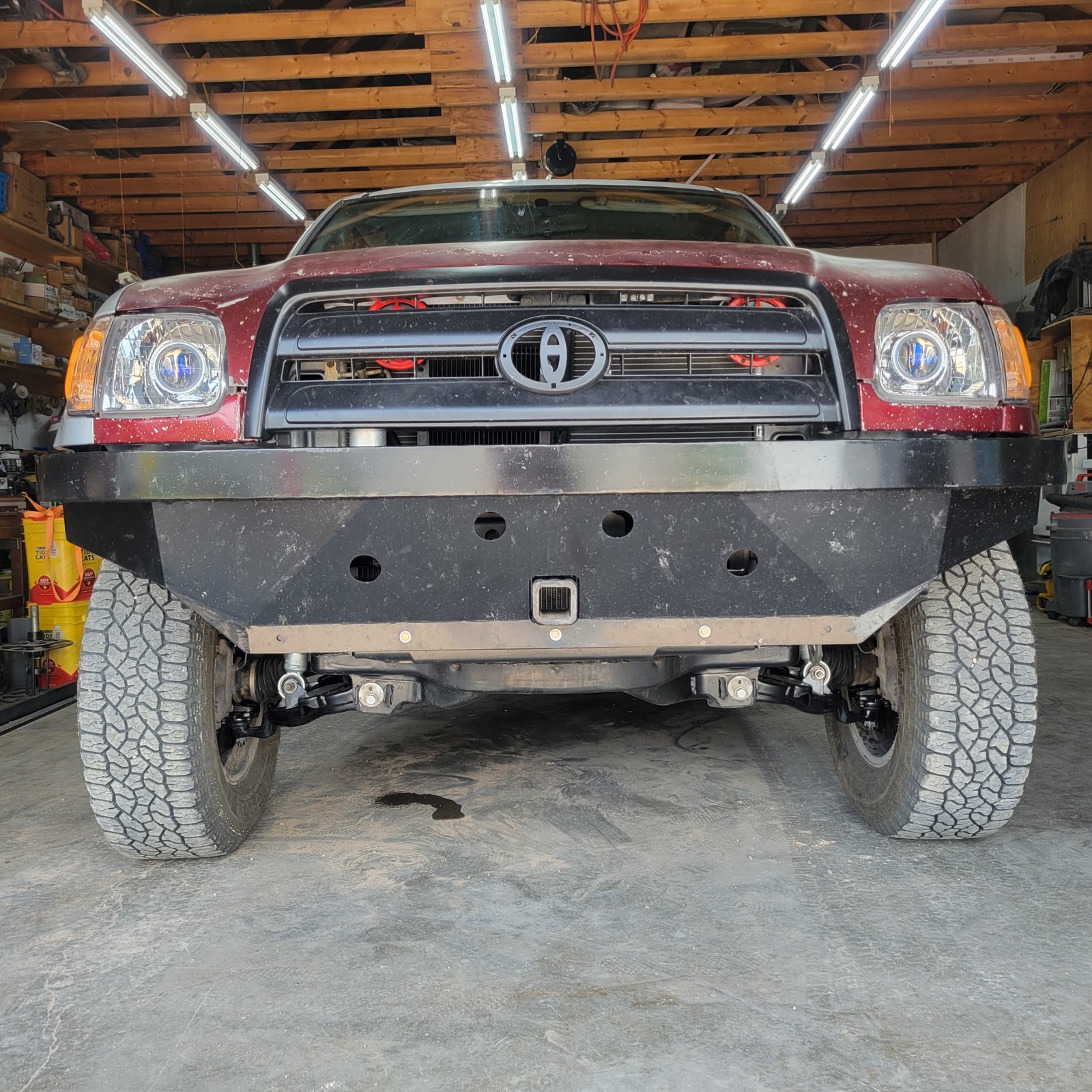

    I miss a lot of things hereo_O... But I don't remember seeing pictures of that front bumper (which you no doubt fabed up)
    Looks great, almost level really :thumbsup:

    Thanks my brother from a Michigan mother!
    I forgot That there's still a full rear axle and set of leaf springs in the bed. I should probably take that into consideration.
    The build thread for the bumper can be found here

    Thanks! Yeah Ide been there and left a like back 7months ago... no way I would have remembered that.
    That thing is stout :muscleflexing:, and I like the snub nose clean look. Nice work

    That’ll come out with the impact. You just need to clean out the rust in the recess. I’m not sure if the non-impact torx bit will work or break though. I just bought an impact compliant t-55 from Napa to get it done.

    You think you're better than me because you buy impact rated tools!?:rofl:
    A little dental pick action and it came right out. Goes to show you how a Bed-liner can trap moisture moisture and corrosion.
