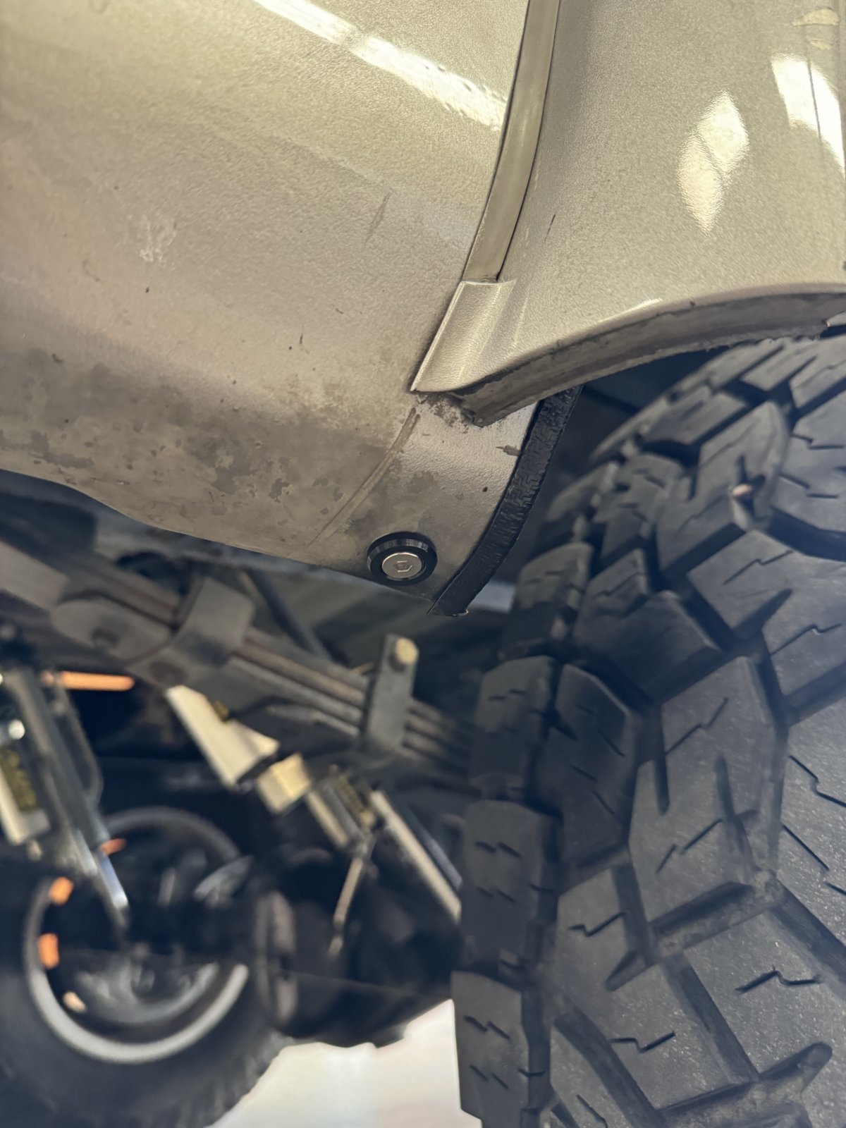

    Oh I made the mud trap worse. Now it just flings up inside the bedside because it's all exposed LOL. I'm with you I prefer not to have flares, but taking that round leading edge away and making it sharp really makes the truck feel more aggressive. Just buttoned up the passenger side. Is it me or these HF Hercules discs last longer than diablo? I smoked 2 diablo's cutting the driver side. Passenger side went through like butter using the HF brand. Also used the Milwaukee hacksaw to get through the wheel well vs the angle grinder. Made VERY quick work. Thanks for the suggestion @shifty`! Not quite what you were suggesting, but damn you saved me like 30 minutes haha.

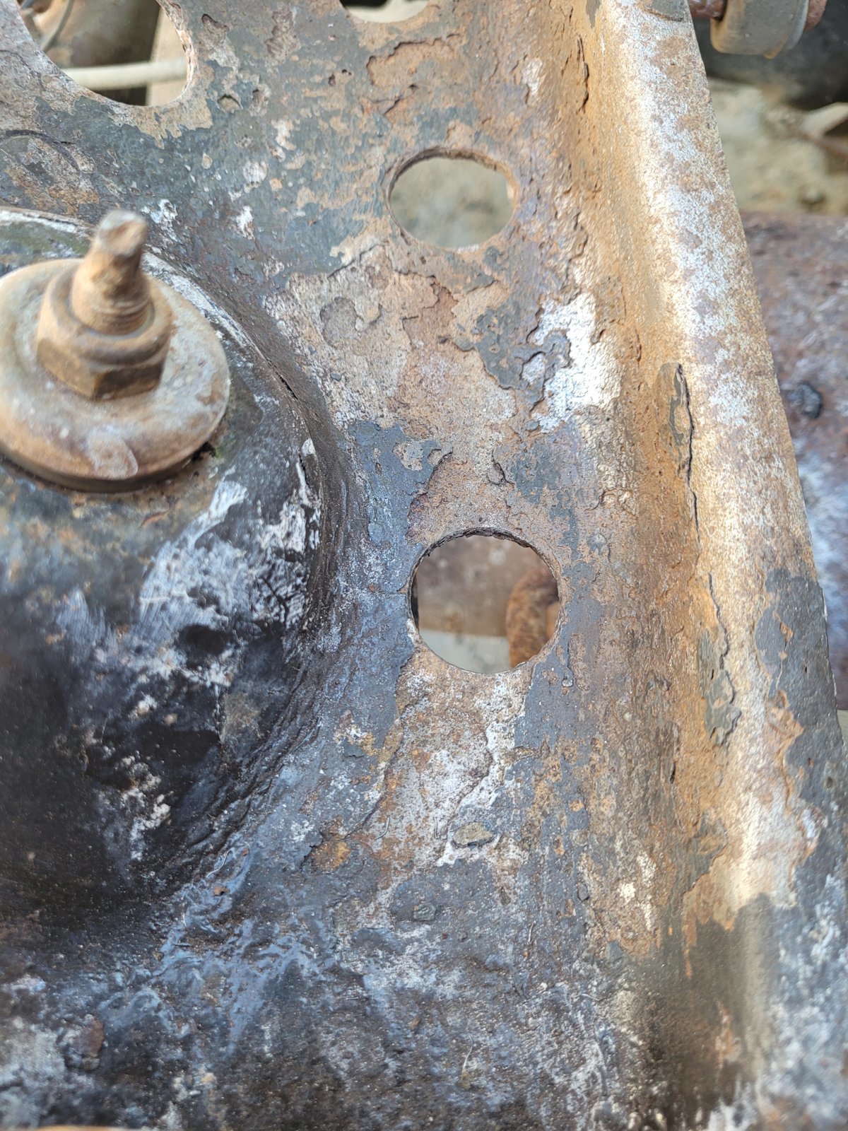

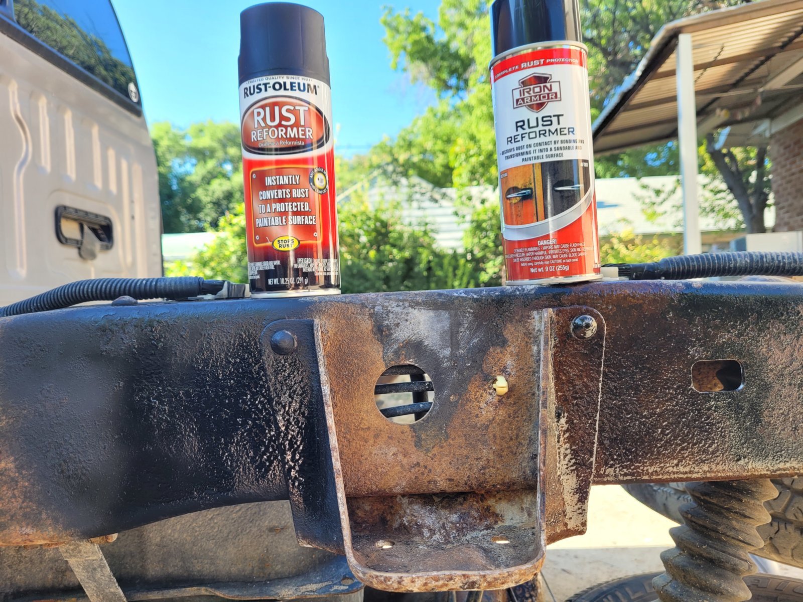

    Did some test patches with the rust reformer options at harbor freight. I was considering POR15 but now I'm seeing lots of people recommending oiling the frame instead?
    I'm thanking my lucky stars, there are no areas with rust through metal. I really don't think ill have to cut and weld anything. I would LIKE to grind out the rivets on the leaf spring hangers to coat the frame rail behind them and use new bolt on hangers. I don't think the condition is bad enough to warrant the $200 right now though.
    The worst bit is on the top of the forward crossmember; right by the shock mount. It's pitted ~0.5mm. I'll bring my small die grinder home from work to get a better inspection, see how deep I really need to go. The wire wheel can't reach in a lot of the tight corners.
    In the same area was the rusted through muffler...
    I cut it clean off. :sawzall::headbang:

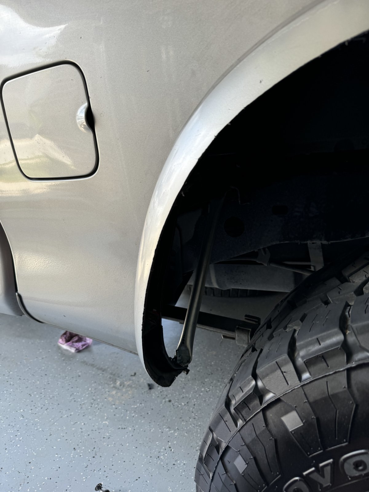

    Bedside supports. Still need to do two more rear of the tire, but I need a new vice. Sledgehammer works to flatten out the 3/4” conduit, but it’s not as clean as I’d like.

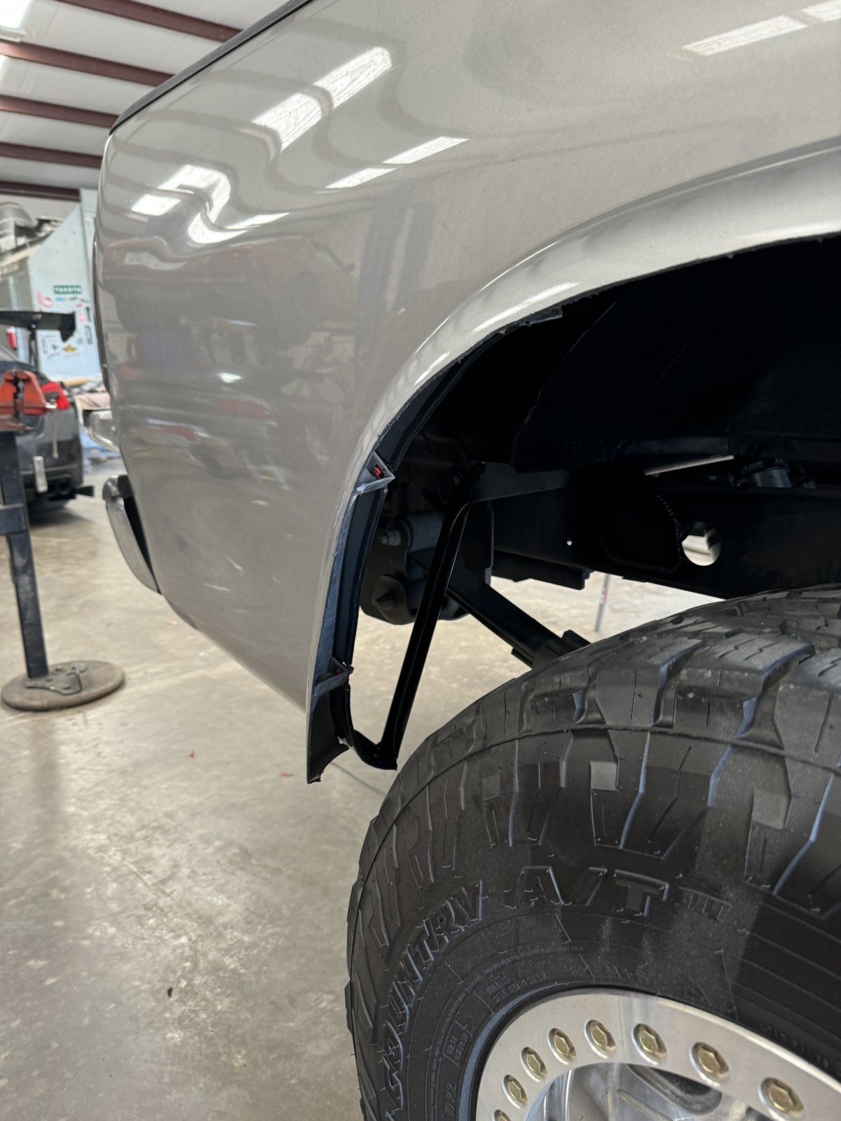

    Popped by my buddy’s shop to borrow his vice. Bed still shakes a little, but it’s at the top of the wheel arch so can’t put a support there without hitting it. Utilizing extra dress up bolts that are on the exterior of the truck to keep it clean.

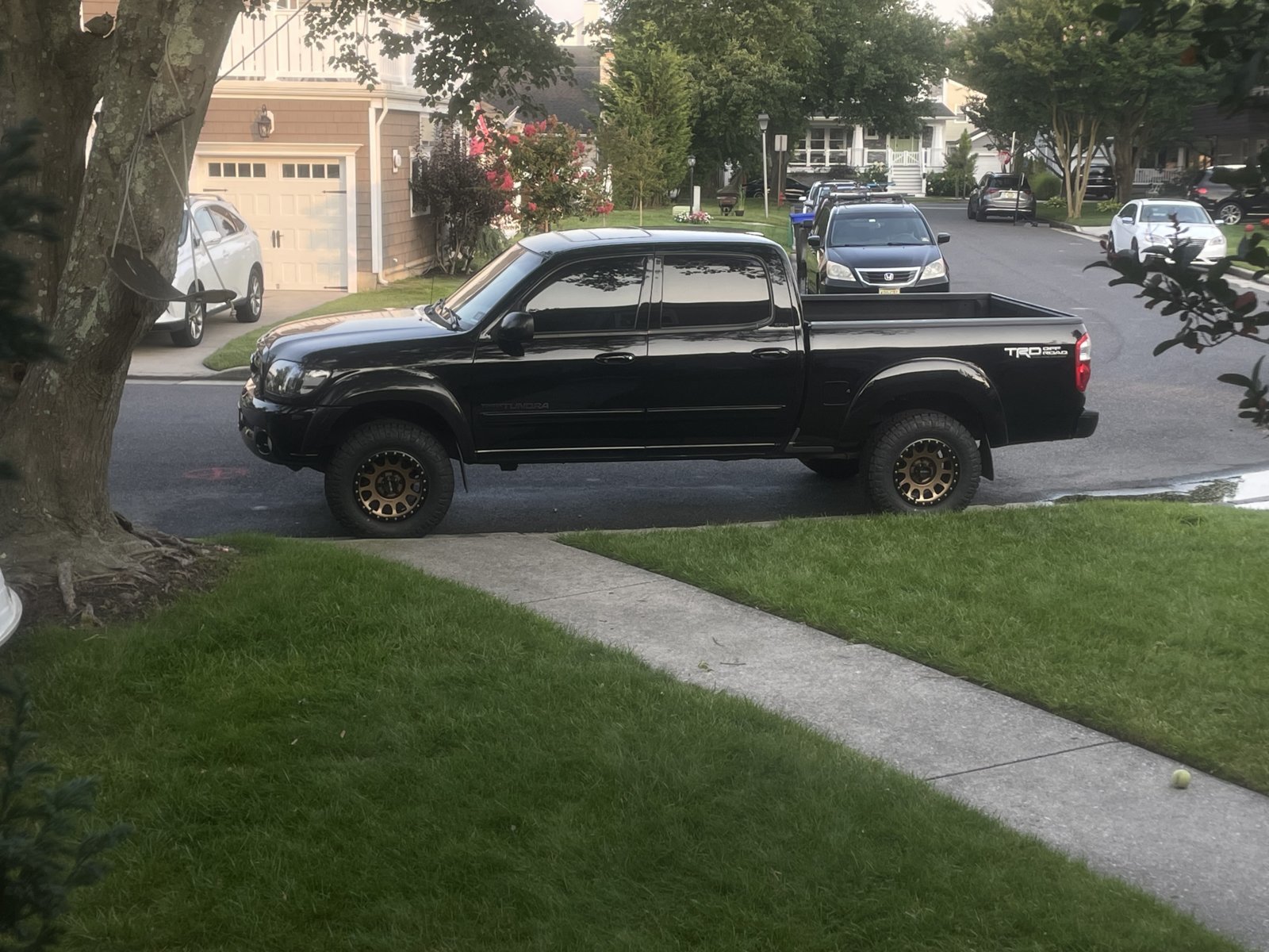

    Put on a new wheel setup. Anyone have any good recommendations for new springs for with my 5100s? I want the front to be level, it’s still lower than i’d like with just the 1.6in out of the 5100s

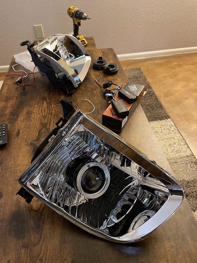

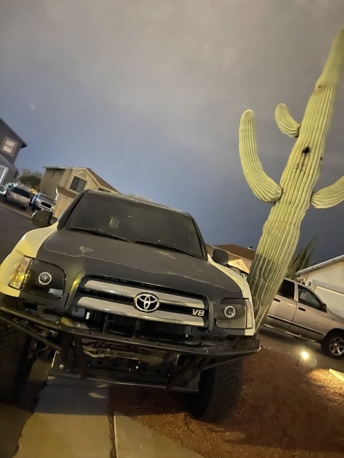

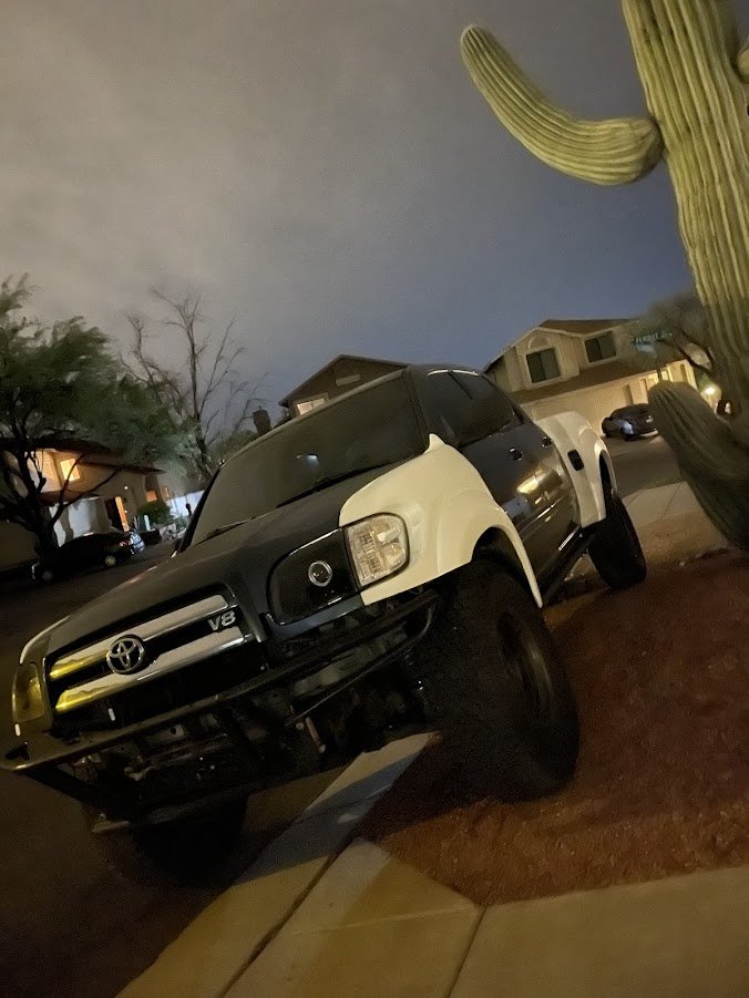

    LED projector retrofit, made my own connections to make it work along with anti flickering module. Bulb is H1 and stock connections are H4, didn't come with a harness. Tested on several washed out areas during this monsoon season, no leaks. Clean cutoff, much needed upgrade from lackluster OEM light output.

    Tonto cover
    Welcome aboard.
    Looks like you snatched up @Swalters ' truck?
    https://www.tundras.com/threads/2004-sr5-dc-4wd-in-arizona.141463/#post-3588787
