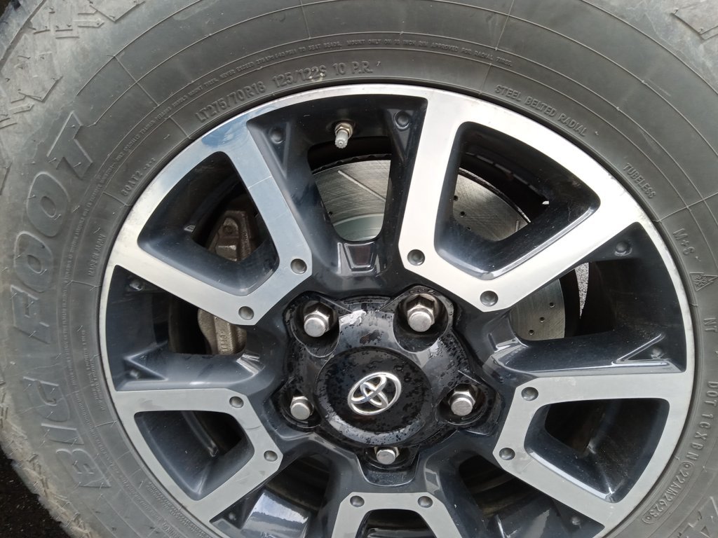

    Working on changing out the brakes. I have the Autozone top end pads and rotors, but the rotors warped and pads are over half worn at less than 2 yrs. Installing Powerstop drilled and slotted rotors with carbon fiber ceramic pads.
    Fronts are done, just giving my back and knee a break.
    Edit: steering wheel shake gone and my truck no longer dances when I hit the brakes.

    Worth the price and effort once all said and done. They will last much longer.

    Hope so. Got the back installed and did the break in.
    Wasn't too much effort though. Pads and rotors haven't even been on for 2 years, so everything came apart easily. I do need to adjust my parking brake.

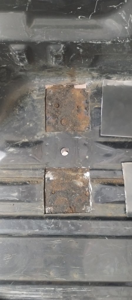

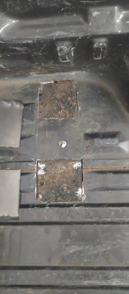

    What gauge did you use? I’m thinking 18-20g

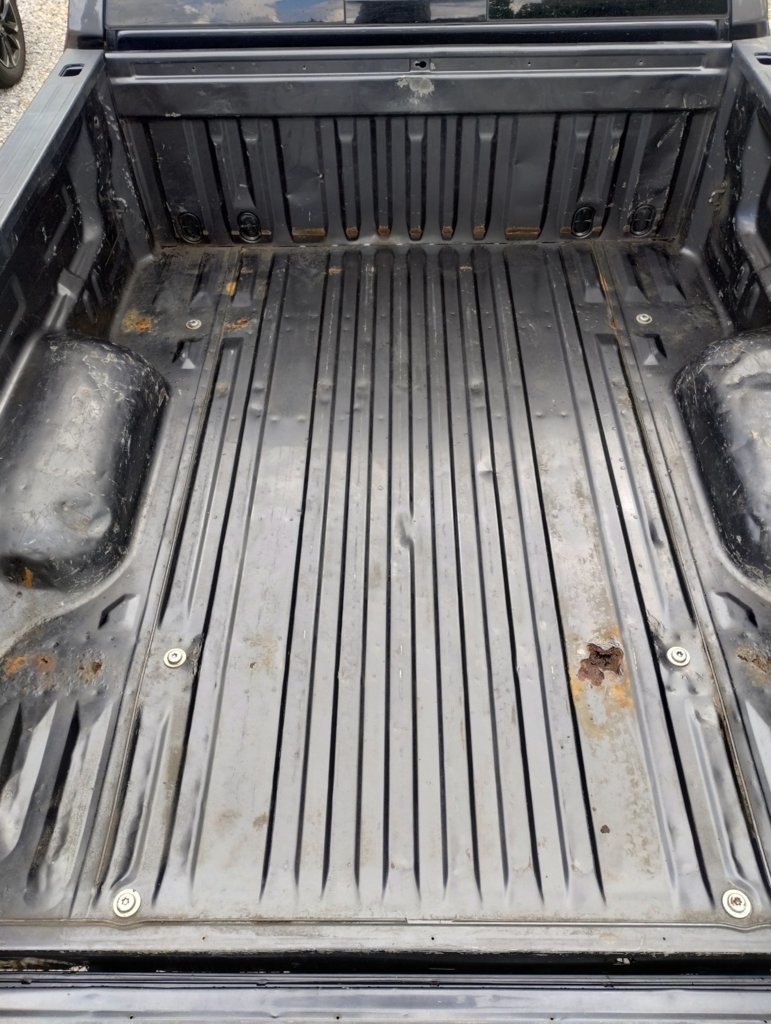

    I used 22 gauge. Originally planned on 16 but it was to thick to shape with a hammer. Here's a before and after having it rhino lined.

    Awesome!

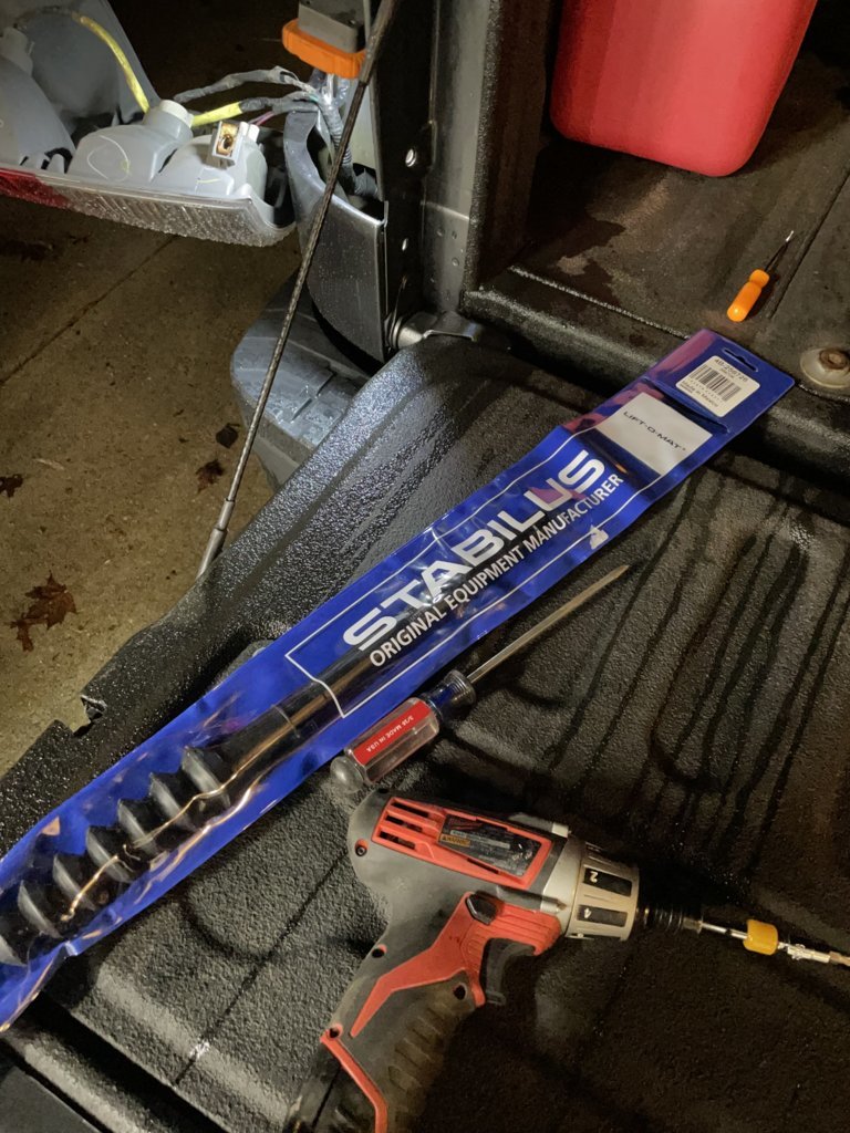

    IMG_0149.jpg Unreal results on a tailgate strut that functions. I can’t believe it took me 1.5 years of ownership to do this.

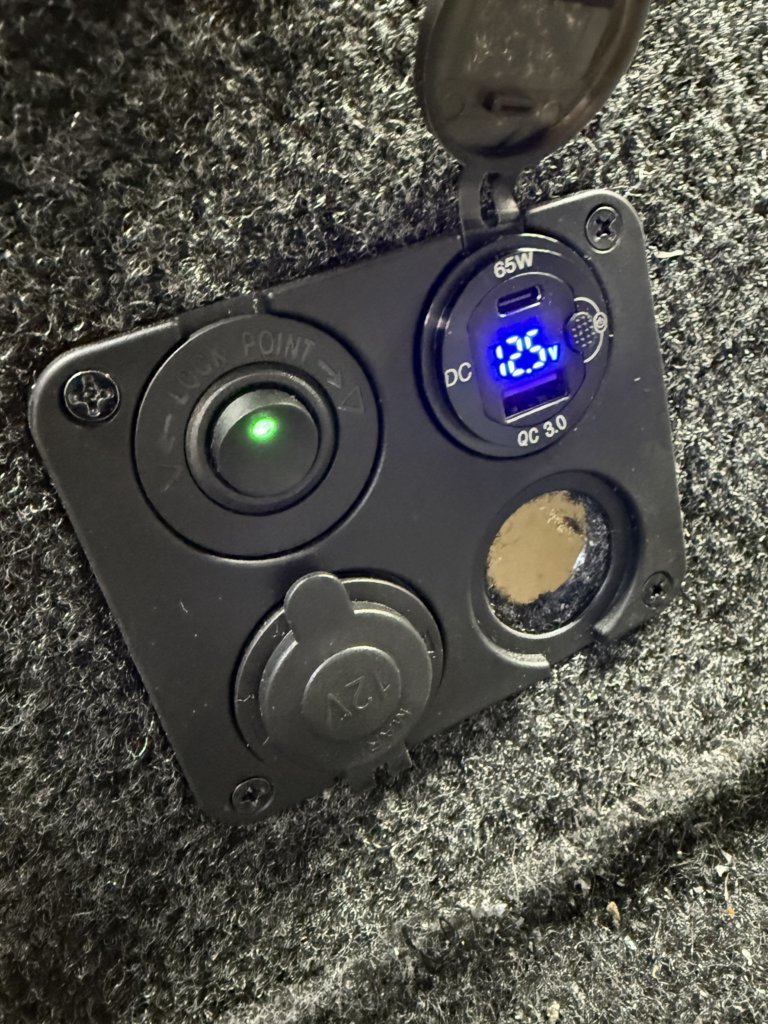

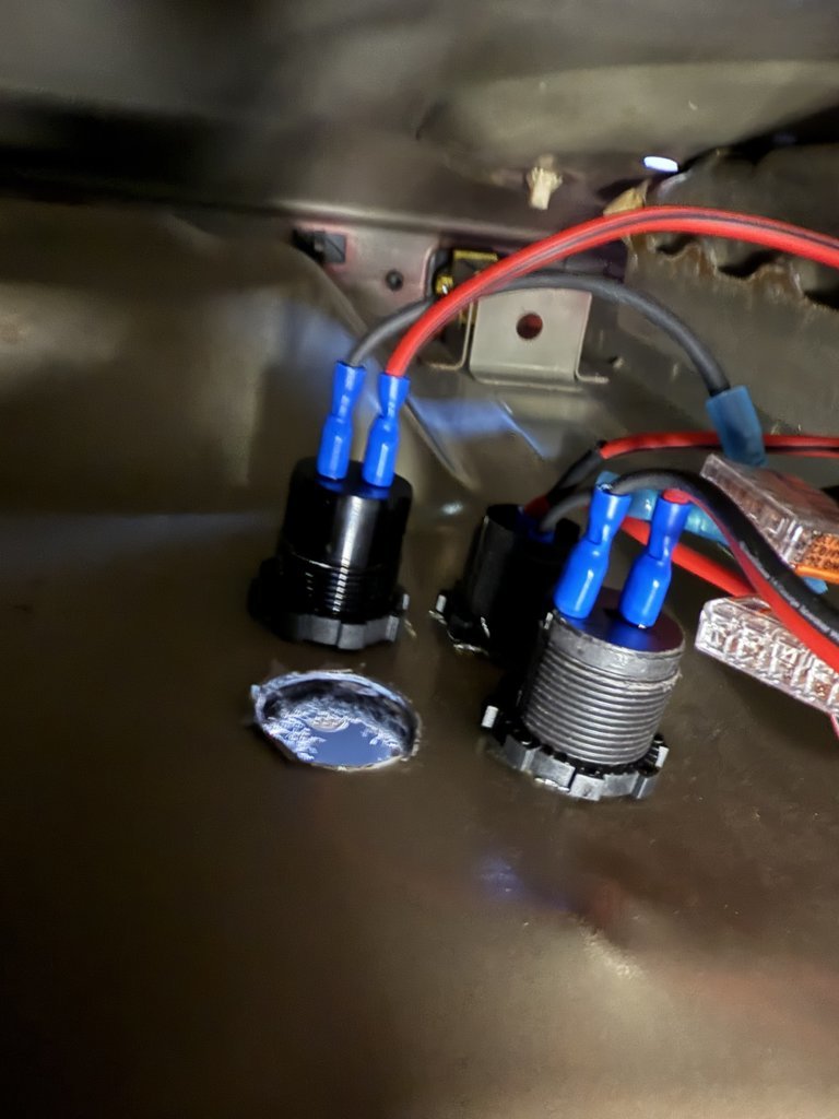

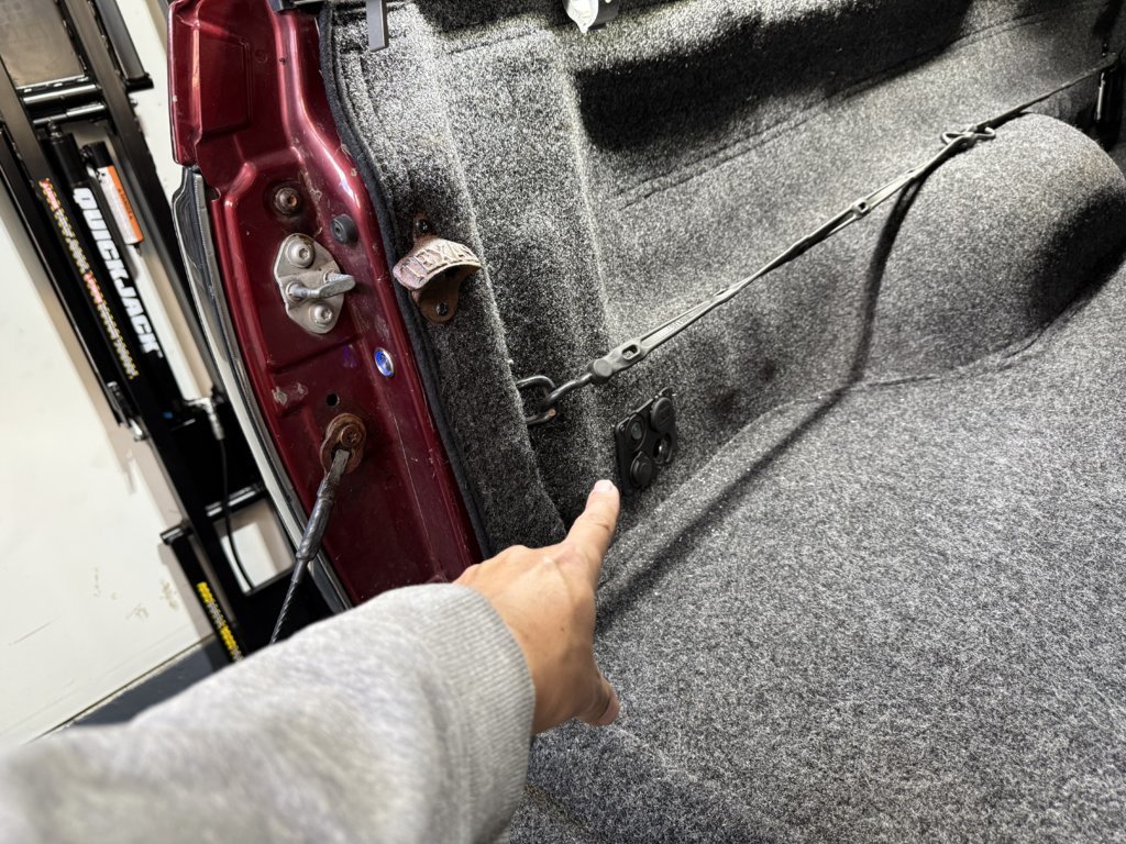

    Added a USB charger and 12V outlet to the bed. The power is constant so I can charge cameras and drones and such when the truck is off. The switch turns the outlets off so they won't drain the battery unnecessarily.
    I have an AGM battery with tons of extra power, and I have an automatic voltage cutoff device under the hood to cut off power to the bed before the battery discharges enough to cause problems starting.

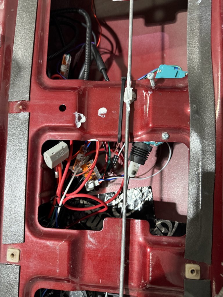

    Backside:
    I ordered a higher powered USB-C charger for the open hole. I'll clean up the wiring after I install it, or at least that's what I'm telling myself now.

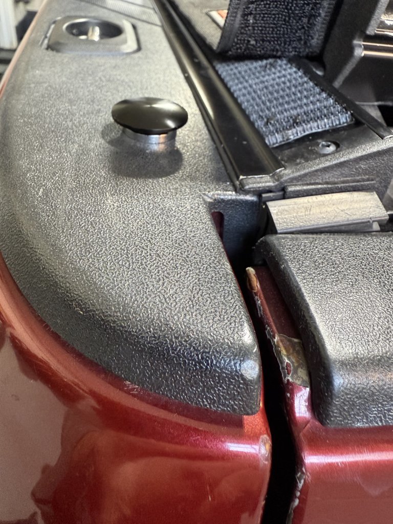

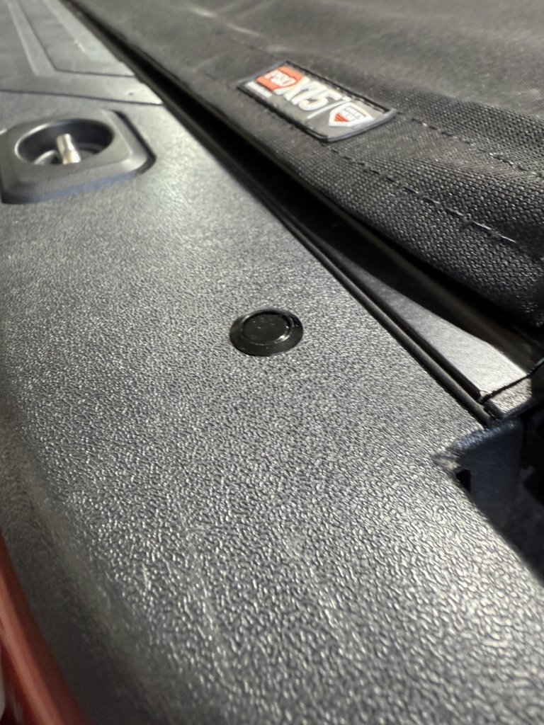

    I also replaced the tailgate opener buttons... The small buttons I used worked great until they got jammed, and getting jammed on broke both the actuators that open the tailgate.
    So I replaced the buttons with bigger more durable buttons... But these are goofy looking. If anyone has a good waterproof momentary button that would work in this spot, please tell me!

    This came out really clean looking. Thanks for the detailed write up on the install. I also really like your bungees with attachment holes through them. Are those the really durable bungees that don't over stretch?

    I bought the bungees 2.5 years ago and they still seem great. I use them all the time and it's really handy to have them ready to go in the bed.

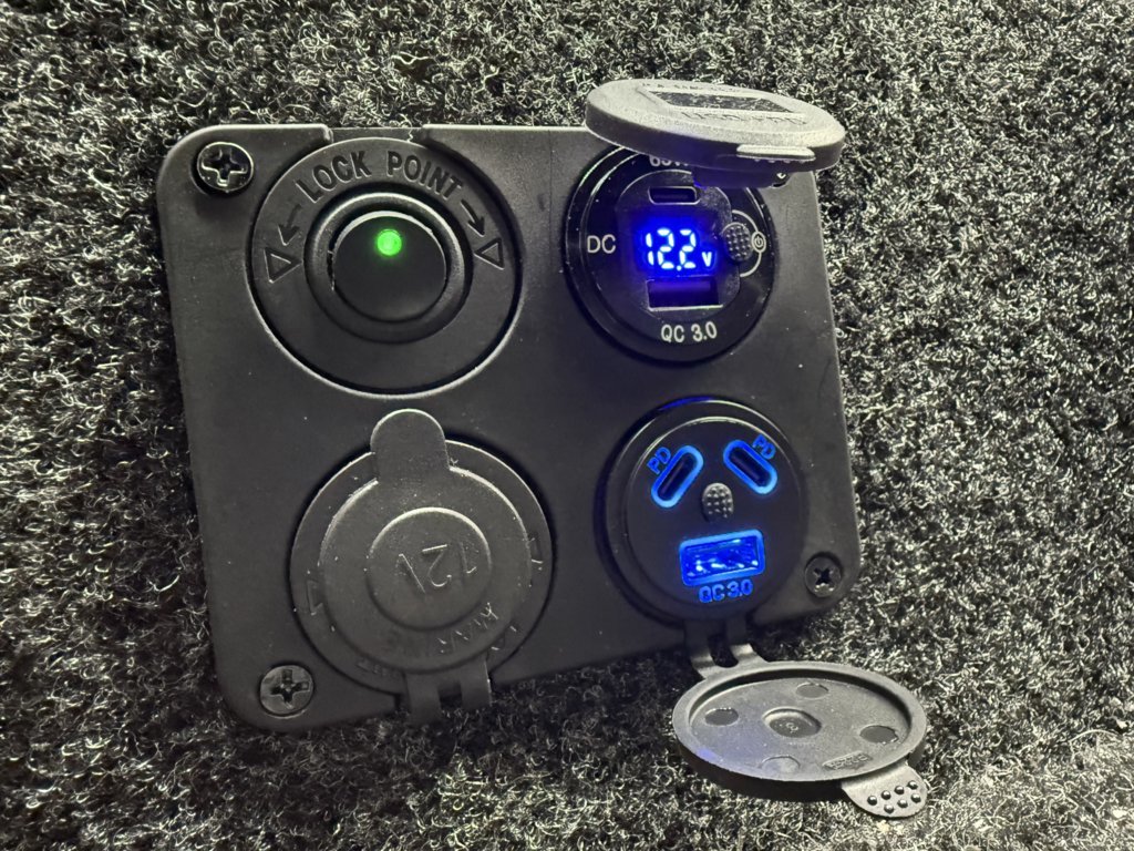

    Filled in the last panel in my bed USB/12V panel.

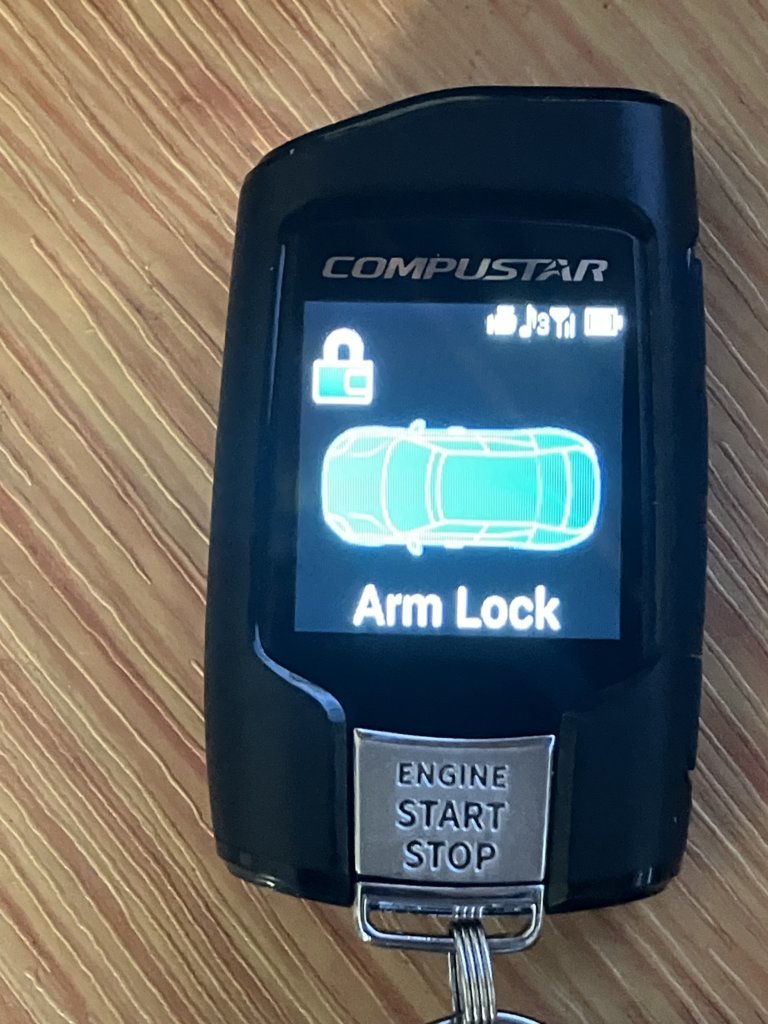

    I updated the remote start/alarm system, the old one way system left me wondering if it was running or not if I couldn't see the truck. It also wouldn't work if I was standing in my living room looking at the truck. Something about this house blocks RF.

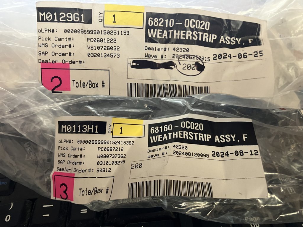

    I replaced the window weatherstrip. Here are the part numbers.
    This video explains the process, it's quick and painless.
    https://www.youtube.com/watch?v=iL82LInTguM
