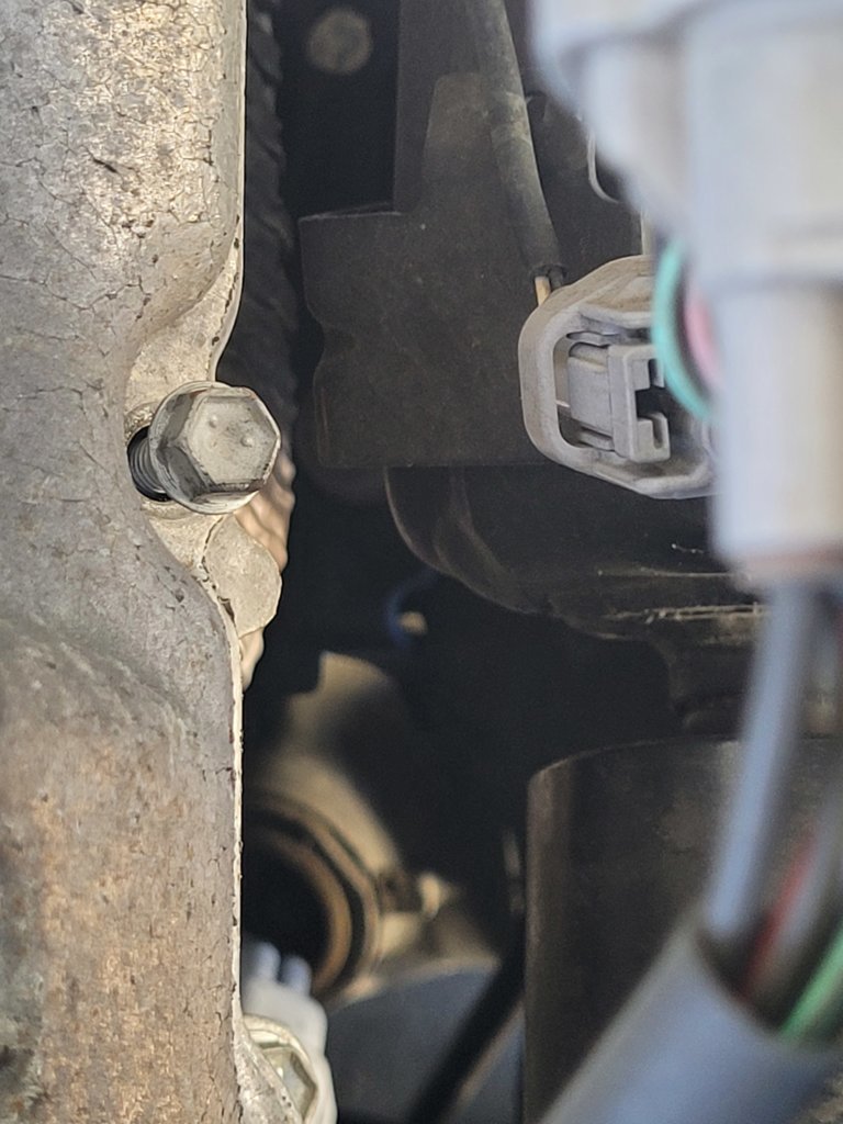

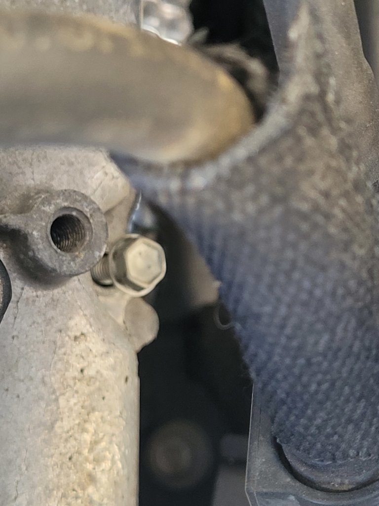

    Worked on the front brakes as I thought I may have had a sticking caliper, the squealing I believe was the Z36 pads being slightly too tall and a shelf of pad material was formed as the pads were wearing down hovering over the rotor. Filed them down, never been impressed with the Z36 kit.
    Also, found 2 valve cover bolts completely loose from when I had a shop take care of the leaking spark plug gaskets. Tightened them up, funny thing is the other side of the motor is seeping from the vc's.
    Have had a front end noise(hard stops on a decline/certain turning angles causing the noise)recently as well and everything looked/felt tight. Only the sway bar links had a bit of rubber deterioration.
    Any ideas? Was going to do the inner tie rods, but they seemed tight, no movement.

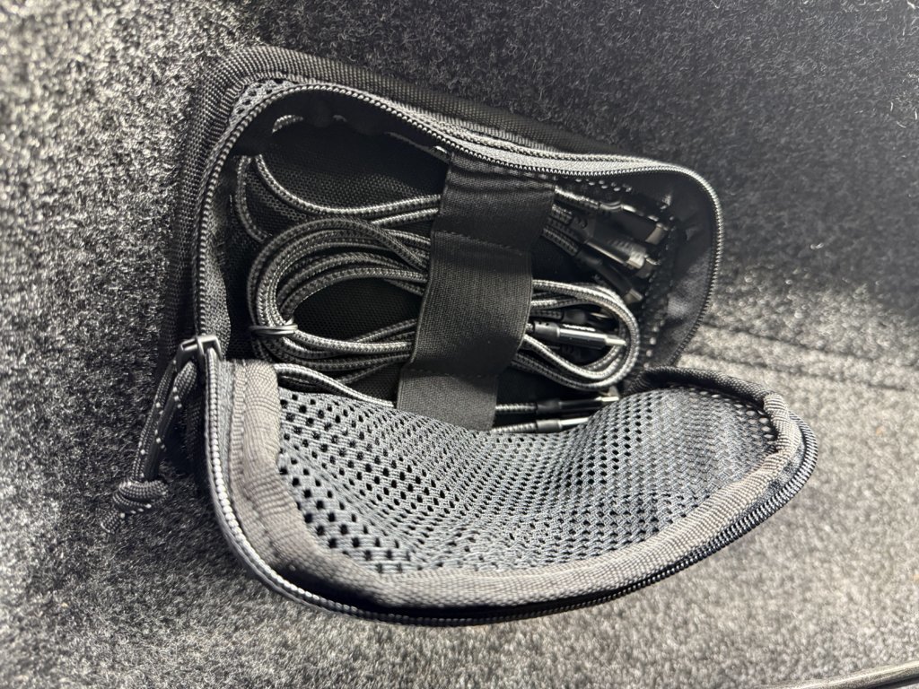

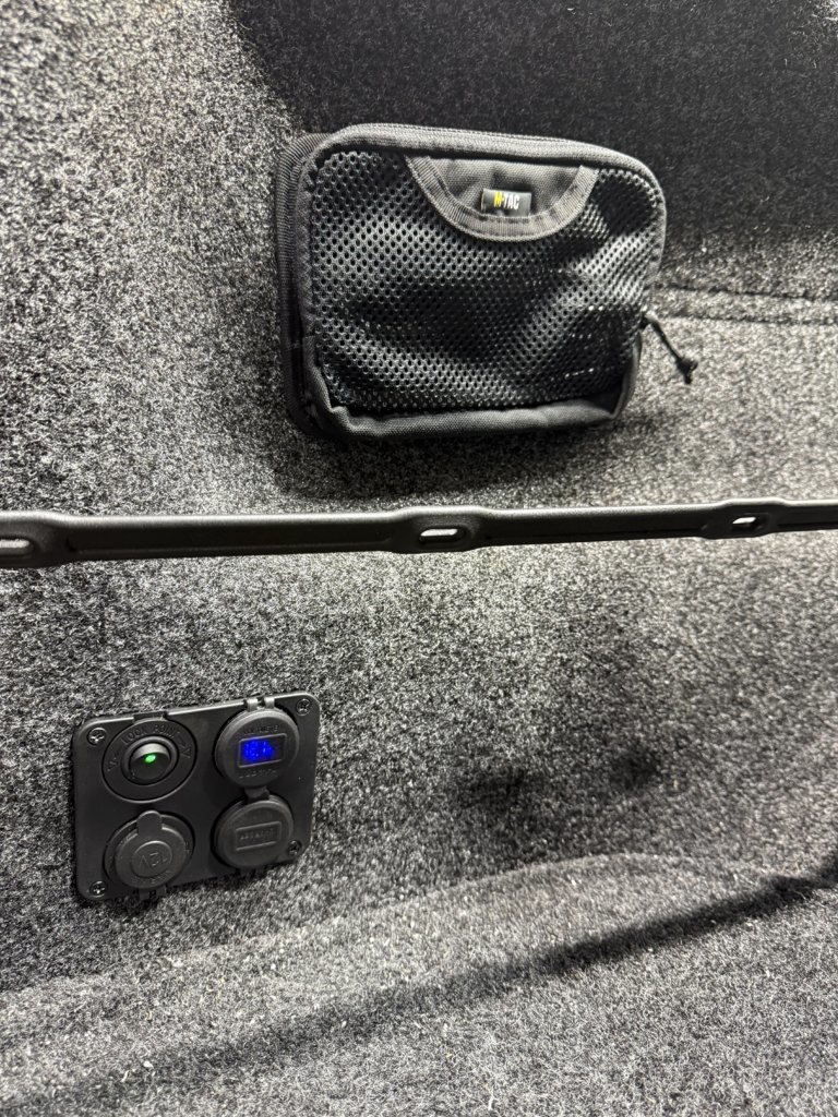

    To complement the USB ports I added to the bed, I got a hook & loop pouch to store USB cables.
    To be clear, this is a tactical hook & loop storage, NOT a Velcro fanny pack.

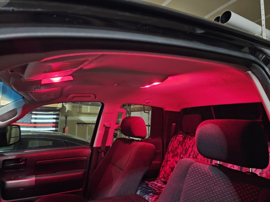

    Just put in some red bulbs. Easier on the eyes for me on early mornings.

    Standard bulbs, or LED?

    Nice, I only did the doors and led strips under dash. Does make it harder to see the wire colors. Haha

    sick, I wish Meso Customs made some for my style of headliner

    yeah I know, he just reminded me of the meso ones but my overhead doesn't support it

    Right on. The MeSo is pretty slick because you can change the colors between red and white. Bummer yours doesn't support it. I also didn't know that the RC trucks were that different when it came to center console lights/dome lights.

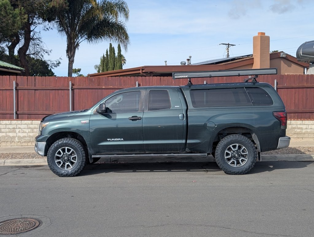

    Pulled the trigger on installing larger tires after trying to hold off until "absolutely necessary." I went with Toyo Open Country RT Trail in 285/75/18. Going camping in Sedona this week, so will see how they perform on Soldiers Pass, Broken Arrow, etc. Previously I had Kenda Klever RTs in 275/65/18 for ~3 years and they got badly cupped and worn (by infrequent rotation or punishing offroading or both).

    That was actually the reason I just went with new bulbs. They make the front map lights for mine, but not the rear dome. :facepalm:

    I have been wanting to get some MeSo lights in mine but after seeing yours I think I might save $100 and just get the lights you linked. I don't think I'll mind if they are red full time. I almost always have the lights turned in the off position anyway because I don't like the bright light when entering my truck at night or early mornings.

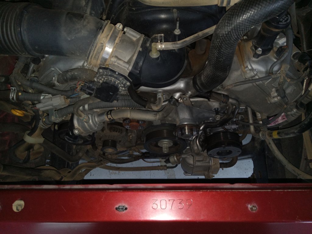

    Pulled the radiator, shroud, fan, belt, tensioner and idler pulleys off. Found the fan mount needs to be replaced, so I ordered that.
    That was all my back could take, so I am done for the day. I'll install the new fan mount, idler/tensioner pulleys, water pump, thermostat, and alternator between wednesday and next week when the fan mount gets delivered.
    I washed the radiator fins out, and holy crap it was packed with dust.
    Edit: decided to go ahead and replace the power steering pump while I am there, so got that ordered from Olathe Toyota.

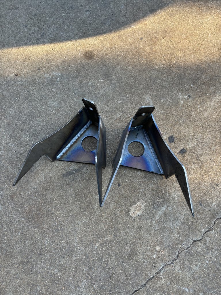

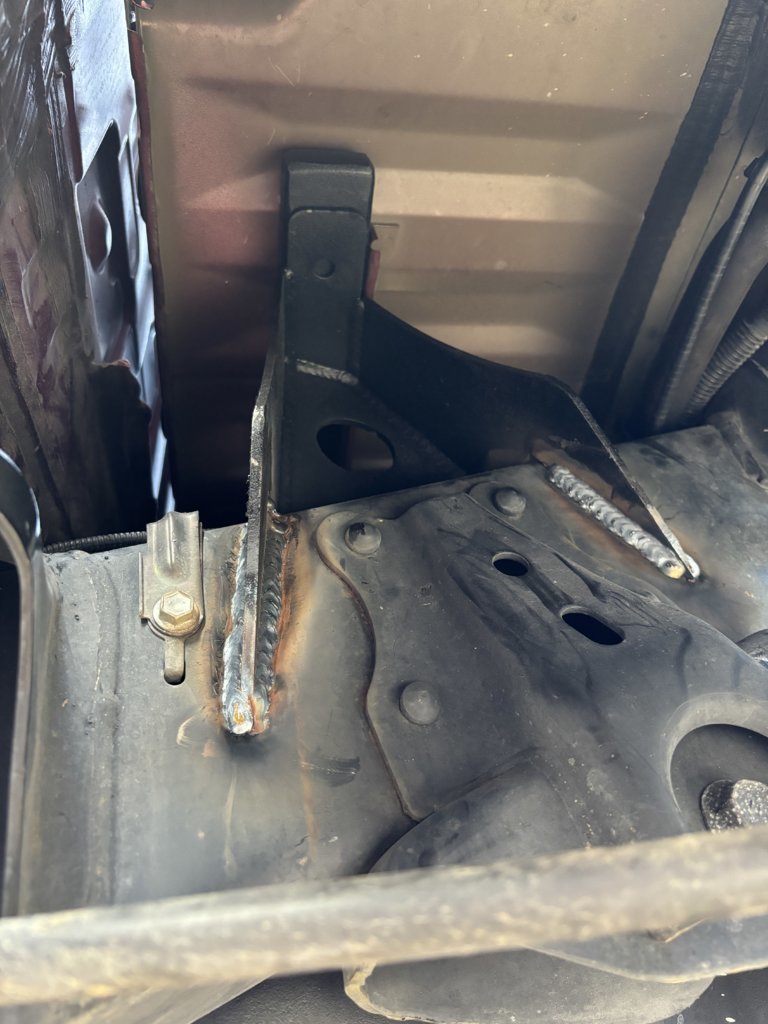

    Few days ago but we made a front bed bracket to keep the bed from cracking.
