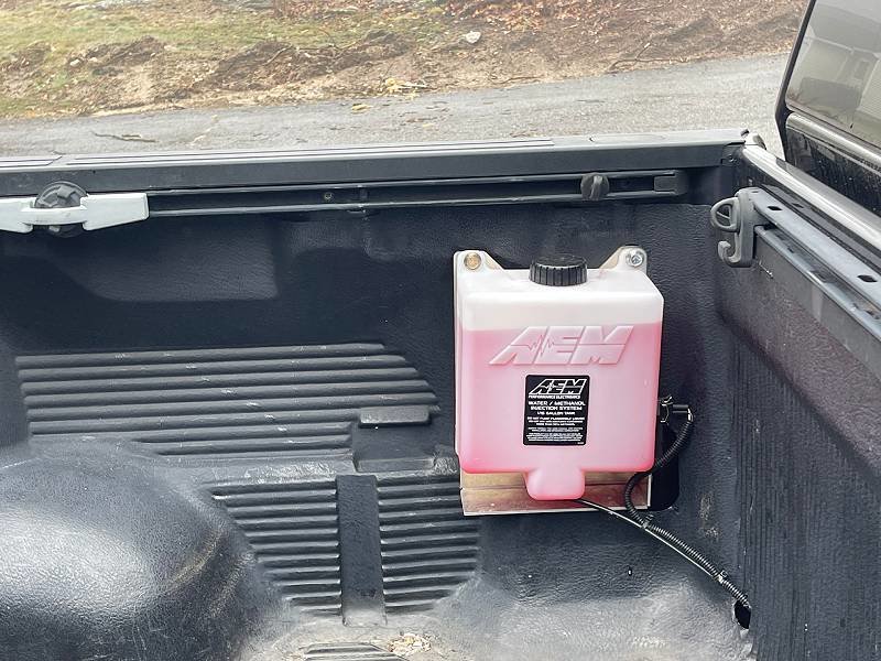

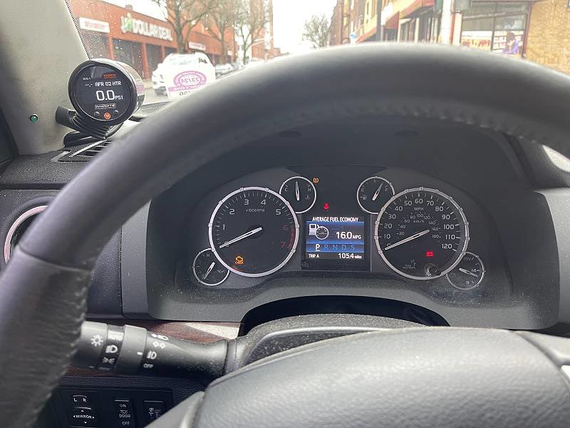

    Tow Results #2: 2014 Tundra, Stage 1 Kit, Water Meth & Tune Only, 4 PSI, 136K Miles on the Odometer
    The quick details of the tow test today:
    U-Haul Car Hauler 2200lbs & 2017 Infiniti Q50 4000lbs: ~6200lbs
    Total Miles: 198.6 (One way trailer only, then back with car. All highway)
    Average MPG: 14.4
    Meth Usage: Less than 1/4 Tank!!
    Duration: ~6 Hours
    Road Conditions: Rain/Wet
    Traffic: Heavy, multiple full stop 15-30min traffic jams
    The trip down was towing ONLY the trailer at 2200lbs. You can't even really feel it, I had to remind myself it was back there in traffic, so I didn't make any super aggressive moves. It was raining and heavy traffic the whole trip. Waze said 1:50 travel time, it took me almost 3 hours due to 2 major accidents cutting 3 lanes down to a tight one lane. I averaged 16mpg with the trailer only and I saw quite a few tenths tick away in traffic, so probably would have been more with a smoother drive. The benefit of the rain, in terms of MPGs, was that it was slower going overall, lower speed, less revs.
    The trip back was uneventful with the car in tow. The motor, turbo, etc did great. The extra 700lbs above the Audi A3 in the first tow REALLY made a difference with the trucks handling. Same great results power-wise with the turbo, but I really felt the car behind it. Granted NYC roads are horrible. I bet the car and trailer jumped a good inch or 2 on one or two of the huge bumps. Once I got out of the city and onto 684, it was smooth sailing. I had it in tow/haul mode and sport mode for shifting. Most of the NYC highways were done in 4th-5th, due to traffic and needing to have the power immediate. On the other highways, I dropped to 6th and only got into 5th a handful of times on some long grades. Again with the rain, wet roads and heavy traffic, there were only a few times I was able to do 65+, most of the time is was in the 55MPH range, which I am sure has helped the MPGs as well. So keep in mind, if you are a hot rod tow guy, cranking along at 80MPH, your results may very, or they may be better, since the motor will be in a happier rev range, time will tell.
    Otherwise, I would chalk it up as another successful tow.
    Here is a link to the log if anyone is interested. I only logged the 2nd half: https://www.dropbox.com/scl/fi/u6w5...1-24.hpl?rlkey=0e35ls8xs5dndrc2k9pt7xclp&dl=0
    *If any Tundra Tuners/Specialists want to take a look at the logs and give feedback, we are always open to learn new things :)
    Route:
    Truck/Trailer/Full Meth Tank:
    1st Half MPGs, Trailer Only:
    Car Loaded:
    2nd Half MPGs, Trailer & Car, plus odometer for overall miles on the truck:
    Meth Usage:

    So I wanted to do the real math in case the dash "confuser" was well, confused. All was solid, I filled it in the AM before getting the trailer and then dropped the trailer and went right to the same gas station, same pump. It took 15.125 gal (I may have topped it off an extra few clicks, but the math is still solid), mileage by the time I dropped the trailer and got to the station, 213 on the nose. 213/15.125 = 14.08 MPG doing the old school method. :thumbsup:

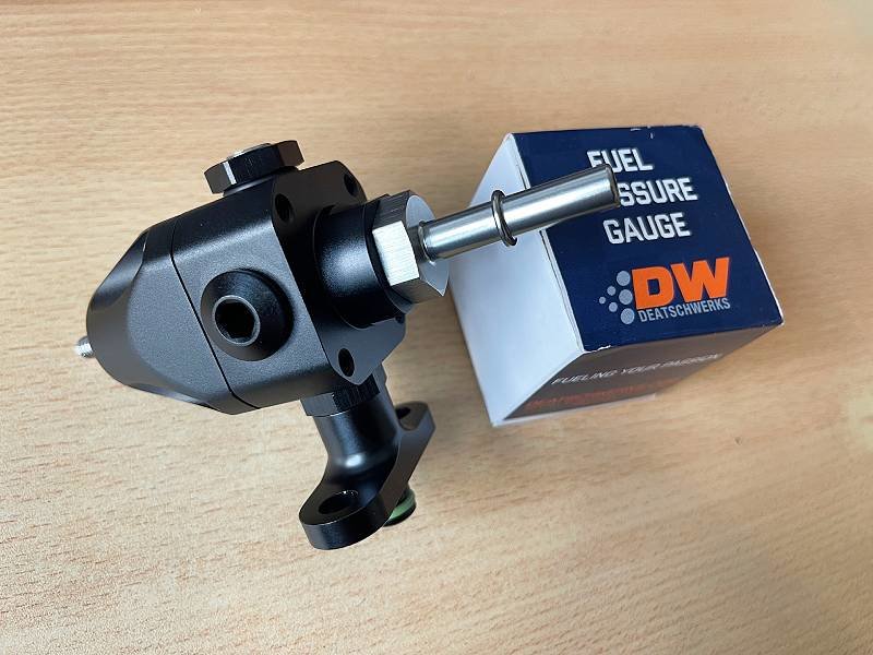

    Another part that came out of this turbo system development was the idea to have a simple, fast and easy to install FPR, since the stock fuel system already references a rail-based fuel pressure regulator, how nice would it be to be able to drop an adjustable FPR in place and bump the static pressure for some additional flow! This drops right in with our Stage 1 and soon to come Stage 2 turbo kits. We are not sure on clearances, etc for the SC guys, but it could be a great option for you all as well with maybe a 90* or 45* adapter. We'd love to test that theory out with an SC owner if anyone is interested. Thanks :thumbsup:
    Check it out here: https://www.turbokits.com/2007-2021-tundra-5-7l-drop-in-adjustable-fuel-pressure-regulator-fpr.html
    Wynnded, texasrho83, ARES35 and 6 others like this.

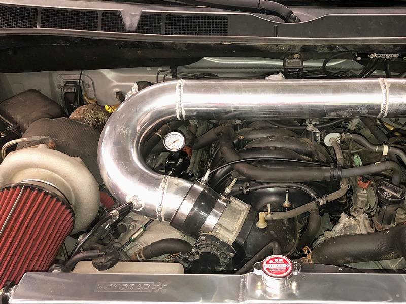

    I could test on the whipple setup I have. @snivilous for visibility on this cool new item

    We'd love too. Shoot some pics of your set up, from the whole engine bay as well as the stock FPR on the rail, let us get a good look at it. Thanks!

    Pics sent

    It could solve extended cranking that we experience on aftermarket fpr's. As they don't hold pressure in the system be it DW, AEM, Aermotive...
    Would be nice if this DW style holds psi.

    What’s the pressure range on this regulator?

    Pressure Range:30-120psi
    Updated the site listing!

    More Info
    External Materials: Anodized T6061
    Hardware/Brackets: 300 Stainless Steel
    Tension Spring: Stainless Spring Steel
    Diaphragm: 35mm Fiber-Viton
    Pressure Range: 30-120psi
    Flow Rating: 500LPH
    HP Rating: 1000 HP
    Gauge Port Fitting: 1/8" NPT
    Ball-Bearing Adjustment: 2psi Per Turn

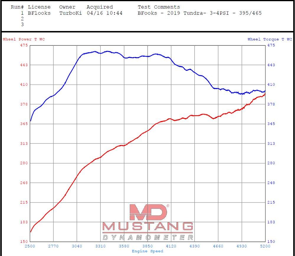

    Another successful Turbo Tundra, NOW onto the heaviest tow testing our stage 1 kit will do!!!
    We had gotten a few questions for updates. First off, with all of the tow testing the last week or so, we did have to buckle down and get some other work done. Also, we kind of wanted to not only surprise you guys, but also BFlooks. He has been on vacation this last week and I leave for vacation tomorrow and we didn't want to burn 2 weeks with no real progress. Especially with time ticking for already planned camping trips. Soooo we agreed, I would grab the truck, work with the tuner to go over the logs and fine-tune for his set up. Which he and I were doing anyway, we just took out one step. Anyway, other than 2 days of rain with no major progress, we got it nailed with only a few revisions (the "base map" from our 2014 is super solid!) The surprise is that BFLooks didn't know for sure if we would have it all done in time to hit the DYNO. It was last minute and was sort of a run what you brought deal as time was limited, but it banged off about 4 runs all within the sameish HP, we had one that did break the 400WHP mark by a few HP, but sigh, we didn't get a video of that one.
    BFlooks, will be testing a towing application and weight that is more than we ever considered for the stage one. So we decided to run a 1.5 PSI spring and the SCG1 EBC to allow us to keep the boost down a bit, plus, if he runs into any trouble towing almost 9K, he can dump to spring rate and knock the boost down even more. Plus as an added safety margin, we dropped the AFRs into the high/mid 10s in the upper revs. The truck feels great, sounds great and we can't wait to hear "it towed great". Here is a quick shot of the DYNO. I have a video I'll post as well, once I get back early next week.
    Anyway, a long, but great day! Till then all!

    That's awesome you were able to get it on the Dyno! I'm excited to have a baseline for the forced induction part of the truck's life (probably just turned 50k while I was gone). Thank you for the surprise!
    I also want to thank you for getting creative on how to keep our schedule. I think everyone was tracking that my DIY install took a bit longer than likely intended. A few factors were at play, most of which was that it was my 2 hands, and only my 2, that accomplished the entire project. This out us about 2-2.5 weeks behind overall, and the remote tuning was progressing, but about as fast as remote tuning does on an early adoption with the newer computers. Anyways, my first trip is only about 4 weeks away, and with my vacation, and Jesse's immediately following, we were effectively losing 2 full weeks. So, Jesse ended up driving 4 hours roundtrip to come get my truck so he could keep working the tune while I was gone, and then another 4 hour round trip to deliver it before he left for vacation. I was happy with the hope to maybe have a finalized tune I could tow with when I returned. The Dyno was more of a "gee, wouldn't it be cool to know if my DIY yielded the same results?" with zero expectations it would happen. And then I got a chart last night, which was pretty cool. Based on an email summary, I'm content with the amount of safety factor @TurboKits.com built into the tune for my use case, and the Dyno numbers I can live with for a starting point with a 1.5lb spring, electronically controlled to 3psi, and AFRs in the 10s even with water meth. So much space to add more power once I can start testing.

    Nice, glad you got to see it flip!!
    Yeah, teflon, just one wrap on the middle/back threads, it'll stop that "NPT seep" every time!
    Ha Ha, like an easter egg in a video game or movie!! But yes, we are pumped it dropped right in, we will be making this an option in production at some point. We have always had a tough time making those in production, since it's way down several feet of piping, so even a 10th of a degree different rotation on one of the VBands, can throw it off enough down the other side of the pipe. I am thinking that was due to all of the connections being VBand, including the turbo hot side. The saving grace on the Tundra kit is the turbo being a hard mounted 4 bolt flange, so less chance of that slight degree off at the other end. Anyway, happy it fit right on!
    Ha Ha, I love driving my 2014, my mom drives it sometimes and she calls it the growler! It makes all the right turbo noises, has boost on demand and is deceptively FAST and smooth. One thing you hit on, that we and really a lot of turbo people don't give enough credit too, because it's always about BOOST and Peak #s. Is the fact that even when NOT in positive pressure, the turbo is flowing more air. As you say above "It's easy to stay out of boost, but it's also easy to gain speed without the traditional downshift or RPM" that's the turbo doing the work that a downshift and higher revs would normally be needed for, even if you aren't technically seeing "boost".
    Absolutely, once we see how it does with the tow you have planned. I am confident we can squeak out some more power!!
    There are two ways to connect the wastegate, you can do it right from the turbo, as a closed loop system. The downside to this is the wastegate is reacting to the pressure at the turbo, not the pressure at the motor, furthermore, the SCG1s logic is to add duty cycle to control boost, ONCE it sees it causing the gauge / control #s to not exactly match the engine PSI.
    The other way to do it, is to connect the wastegate directly to the same vacuum/boost source at the motor, the one you run the gauge, meth, BOV, etc from. I like this way, since then the wastegate is seeing the same signal as the rest of the components.
    The struggle with your exact set up, as mentioned before, was the 1.5 PSI spring. It's not enough spring pressure to even keep the wastegate closed from exhaust pressure, so it tends to always be cracked some, hence the tad slower response and lower TQs than the 3 PSI spring. I think once you clear the tow testing, we should drop the 3 PSI spring in there and see what you think :)

    A question came up on using this with the tvs2650 SC. The factory fuel regulator is already a tight fit. The measurment between inlet orbs on the dwr1000 is about 1 3/4 inches and the height to fpr adjustment set screw is roughly 2 5/16 in.
    It should fit. But if it doesnt...
    Is the fuel adapter to the rail an orb fitting or npt? I found a 90 deg double -6 orb that could help instead of the straight coupler. Do they come in 22.5 deg 45deg? Just thinking of a way to kick it away from the side of the SC if it doesn't work.
    Screenshot_20240419_152914.jpg Screenshot_20240419_105238.jpg Screenshot_20240419_155650.jpg
